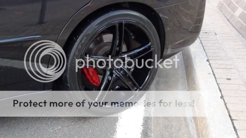

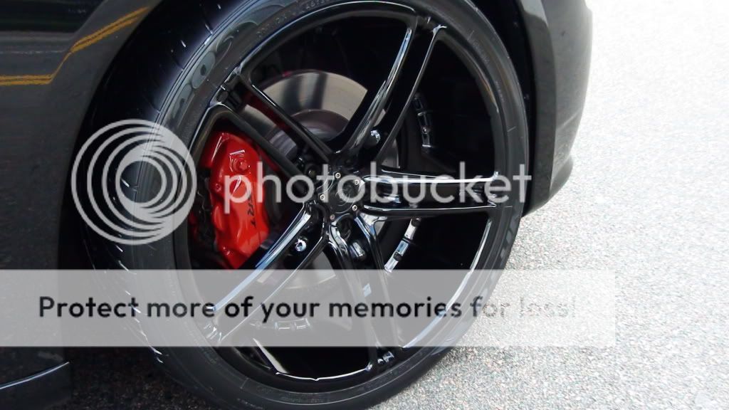

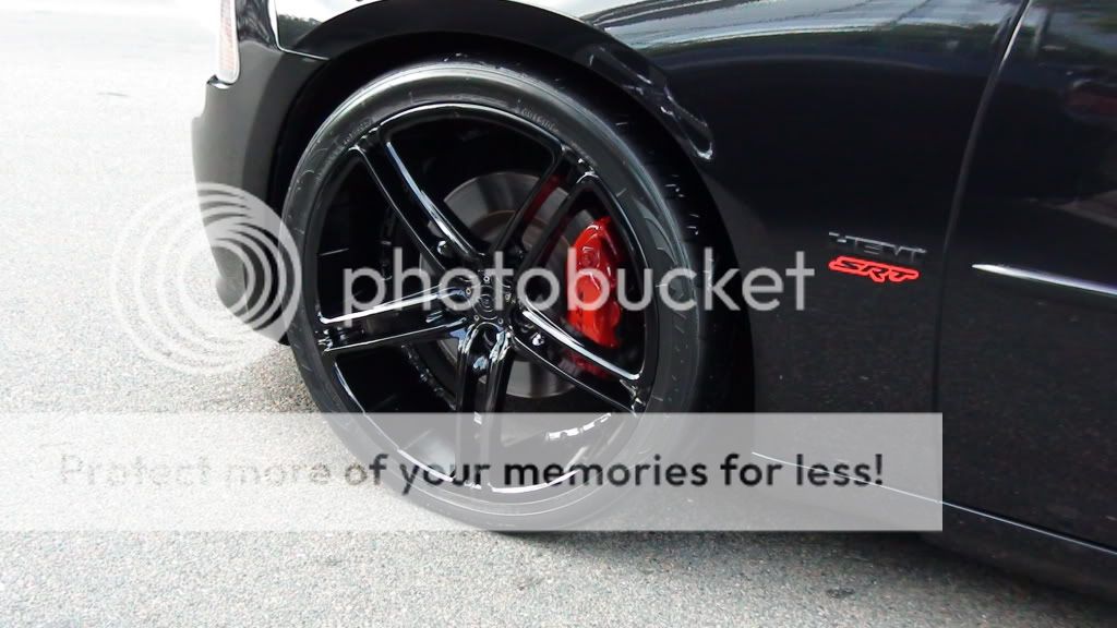

Well painted my brakes do to the stock brembo clear was peeling off, added SRT logs...Just in time for the show,,,,

Thank for the comments.....I used and engine 2000 degree primer then used the Dupli-color caliper paint. Its all in to the prep work sanding and cleaning really good before painting. The SRT logos are stickers from Austin.....

It really is not hard just sand smooth and make sure you clean them really good before you paint. Then just spray light coats until the desired shine. Use a good brake cleaner and tape off your calipers. Use an Engine primer so your color is even........Go for it!
