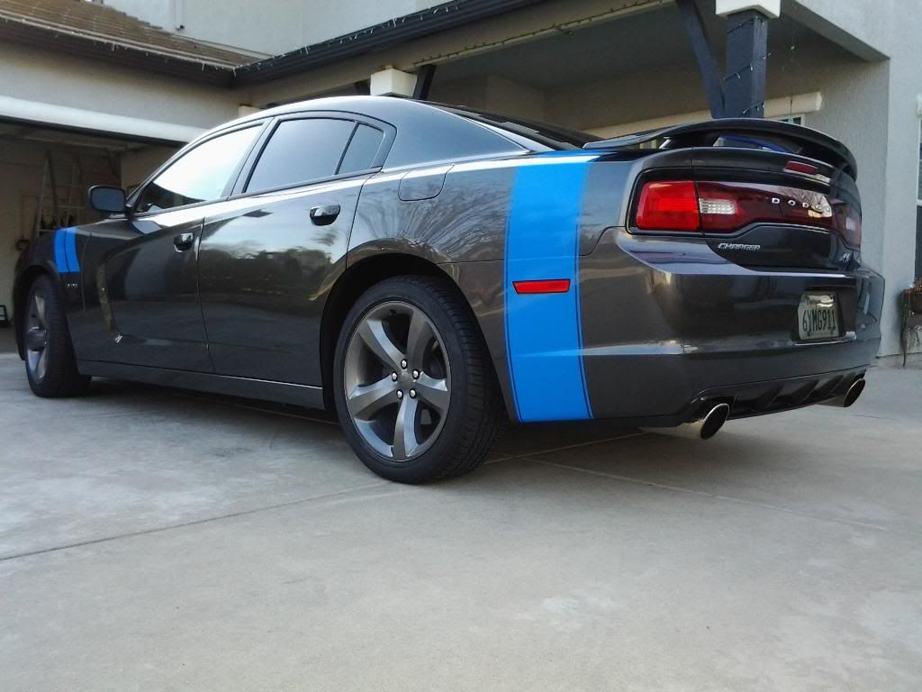

Here is a good thread:
http://www.chargerforumz.com/showthread.php?t=138739
IMO the round tips look good on the R/T's after you get the square pegs out. Either chrome or black. I bought the chrome borla 4 inch tips and plasti-dipped them matte. No problems with heat. They have over 4000 miles on them.
